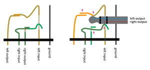

This Headphone jack assembly if working correctly is passive (some models have the DAC circuitry within the assembly). I would inspect the connector interface both sides for any damage. How about posting some nice tight focused pictures so we can see things too.
If the connector interface is not damaged or corroded then the logic within the logic board has a problem which switches the signal electrically Vs mechanically.

The image is showing the mechanical switches within the jack as reference, within the logic board is a transistor switch setup that takes the mechanical switch’s signals and applies the same action electronically. This is done to lessen the exposure of signal noise is as best I can understand. It’s not that common an approach. Just like how Apples power button is a soft switch on its systems instead of a simple pole based switch.
Here we are focusing on the headphone jack assembly’s connection to the logic board that interface is what needs to be inspected before diving deeper into the schematics and board view drawings to measure the resistance & voltages
