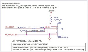

While researching a problem(*) I noticed that on the back of the mainboard, just next to the battery, there is a momentary switch with "SW4" in white next to it.
It can be barely seen from the top - see pictures

There is no access to the switch from either the kb or the bottom.

@eyal34026 that is a service mode switch for updating the Flash memory region.

This is the service mode switch, which is typically not necessary for common issues like yours. It is mainly used when formatting the ROM or cleaning the mE region for BIOS purposes. It's unlikely that this is related to the problem you're trying to resolve. If your laptop is not detecting AC power, check the Vbus_AC detector and the DCIN_ACOK. Also, verify the power around the BQ24777, including VCC, ACDET, and ACOK. Additionally, inspect PQ304 and PR327
