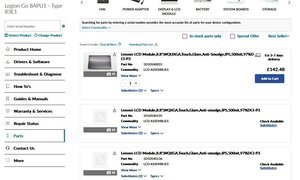

Here's an image showing the part numbers¹ for all the LCD modules that are compatible with the device.
Search online for the part number only to find suppliers that suit you best.
(Click on image)
¹ The Substitutes (2) link for each module just shows the part numbers for the other 2 modules shown in the list.
