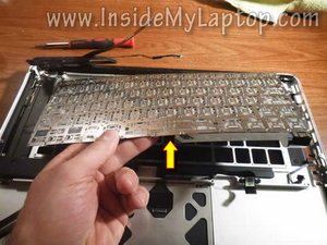

Yes, you can replace just the keyboard.
You can use this guide as an example:
Replacing keyboard on MacBook Pro 15" (Mid 2010)
The guide is for a different model but should be very similar.
