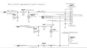

A this point you’ll need to do a detailed inspection on the logic board looking for damaged or burnt components. I suspect you have a short which could be a blown Power VRM or capacitor
@raxxx I am certain you at least already tried a SMC reset. If not, start with that. Next, let's look at the diagnostic LED's and when they should work and possibilities why they are not. For now, we'll stick just with LED 1

For now, I suggest you focus on the power supply. You told us you replaced the power supply but you did nto tell us if you checked that it A. gets power from the outlet and B. it does have power for the logic board. If you check the functional overview for your iMac you see that the no power issue is focused around the connection from the power supply to the logic board 2020 IMac 27inch
You can check the voltage on pin 4 and pin 5 and let us know what you get. Also, you may consider taking a couple of large, well-focused pictures of your logic board and post those with your Question. That way we can see what you see and hopefully guide you further. Adding images to an existing question
Do not forget to check the power button :-)
Last but definitely not least, go through the Apple recommended 2020 IMac 27inch No Power Troubleshooting Let us know what you find out.
