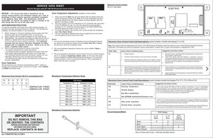

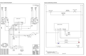

I have replaced both the baking element with a brand new one and the Electrolux control board and only my broil will work
Hi @calvinwhit53917
Since you have replaced the bake element and the control board it's either an open wire between the broil element and the bake element or between the control board and the bake element.
If you have a DMM (digital multimeter) with the power disconnected to the oven, check for continuity of the wire from the L2 Out terminal on the control board to one side of the broil element and then to one side of the bake element.
If it tests OK then check if there's continuity from the BK terminal on the control board to the other connection on the bake element (not the same bake element terminal that you tested before.
Here are some images showing the service data sheet that may help. The 2nd image has the schematic which shows the wiring for the bake element). I've marked the 1st possibility i.e. open between broil element and bake element, with a red cross and the 2nd i.e. bake terminal and bake element, with a blue cross in the 2nd image below
