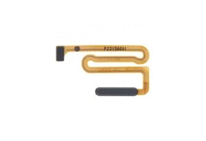

@samuelajayi @wilfredswart you will need to replace the fingerprint sensor flex. Since iFixit does not yet have a guide for that, use something like this video to get into the phone. To replace the flex itself you will have to find your own way. The flex itself looks like this
and it is readily available.
