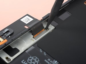

Hi, the phone screen cable ripped apart.
Does the ifixit Pixel7 screen repair include the screen& cable to the (presumably) motherboard?
As you can see from the picture on the iFixit Pixel 7 Screen page, it does include the somewhat short cable between the screen and the motherboard.
Here's how it connects to the phone.
