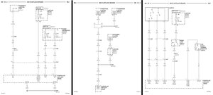

Here's an image showing the wiring for the 2000 Grand Cherokee abs controller that may also help.
(click on image)
