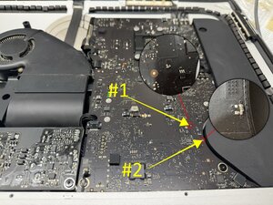

While disassembling my old 2017 iMac for a SSD upgrade I accidentally bumped the logic board and 2 small circuits got damaged. I completed the upgrade and now when I'm trying to boot it up the screen stays black and only the first 3 diagnostic lights on the logic board light up. would these circuits be the reason for that or is there some other problem as well?
heres a picture of the damage
@kyler61164 looks like your board is a 820-00629 (if not let us know ASAP) and there are no boardviews available for this. Some sections on the 820-00597 are somewhat similar but not identical for the whole board. In the case of your components and verifying with the schematics at hand, the one marked
#1 is a 2.2µF 20% 25V capacitor in a 0402 package
The next one is a 1000 PF 20% 25V Capacitor in a 0402 package.
You do have a torn solder pad which may complicate the repair. Scrape the solder mask a bit more so that you can possibly rebuild the pad. #1 is on the GPUCore rail and #2 is on the VReg 3.3V S5/5V S4 rail
If unsure and since you still have the components, use a capacitance meter and check the two components values. You can then resolder those or replace them if need should be.
@oldturkey03 Thanks! I believe the board is the 820-00597. Those capacitors will be my problem then. I don't quite trust myself with that delicate soldering, so I'll have to look into getting it repaired.
