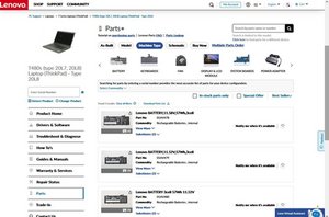

Looking to replace my Thinkpad T480s battery with this:
Lenovo ThinkPad T480s Battery - 01AV478
However, I don't see my model listed in the compatible devices list (20L8S49R00).
My laptop does use the same battery model though (01AV478).
Just wondering if it is compatible so I can go ahead pull the trigger on this because at the moment my battery barely lasts an hour.

Hi @david66813
The battery you wish to purchase is compatible
Below is an image from the parts list for the laptop showing the part numbers for the batteries that are compatible with the model.
Note: the 2 substitutes for each battery shown in the list, are simply the other two listed i.e. any one of the 3 will work OK
If you haven't already got it, here's the hardware maintenance manual for the laptop. Go to the bottom of p.74 (81 of 113 pdf) in the manual to view the beginning of the built in battery removal procedure.
