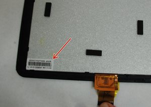

One other way to locate a replacement part depends on the fact that very few laptop or tablet manufacturers actually make their own screens; I'd say probably 80-90% of them buy their LCDs off the shelf. So you may be able to find a replacement by finding out the manufacturer and their part number and searching based on that. If you take a look at the back of the screen, you'll find a label; copy down the model number from that and search for that number. Here's a picture from the screen replacement guide showing the label on theirs; it may or may not be the same as yours.
If you decide to brave the listing I posted, I'd suggest you remove your LCD first and compare it visually with the one they're offering. In particular, look for the position, shape and number of pins on the connector itself; if they are pretty much an exact match to yours then it's a pretty good bet it'll work.
