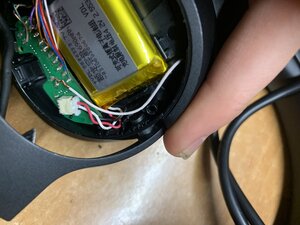

The hinge is broken how do I fix it?
One of the hinges randomly broke and now the headphone is pretty useless as I cannot use it though it works well. I would like to know if anyone knows how to fix it. Also I fixed it once with some superfix glue and tape but that broke as well as it wasn't fitting properly on the head.
If anyone has any suggestions or tips for repairing please let me know.
Thank you
ive pretty much managed to fix it but its not so easy and doesnt produce perfect results unless you can get your hands on a new hinge assembly ( then you need to resolder the cable but id say its a better idea)
bassicaly
1 open the back side of the earcup
2 remove the hinges ( just pull/push and the should come out )
3 remove the shiny plastic on the headband ( i cut dont the middle to make it easier , not sure if its possible otherwise as my still cracked)
4 push out the metal rod
5 pull out the metal rod with
6 remove the swinging part of the hinge
7 cut it in the middle
8 try to heat connect the broken hinge parts
9 rejoin the swinging part with the turning part inside
10 put the metal rod back
11 shiny black plastic back on
12 rejoin the bigger hinge ( cups to headband
13 close the cup
done yippie
dont mind the guide being mid as im just frustrated i cant really fix it nicely without the hinge ( that jbl doesnt sell ) and its 23;20 :3
