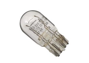

I understand the stop light and tail light are one but only the stop light works will be that even rifle or cable is damaged or should buy another or has some other solution ?
Your Stop/Tail light bulbs are actually two bulbs combined into one; that is, there are two light bulb filaments inside one glass envelope.
As such, either one is susceptible to burning out while leaving the other filament intact. Here's a picture of what I'm talking about.
So there is probably a 95% chance that the only problem is a burned out filament, and replacing the bulb will fix it. It makes sense that it's the tail light bulb that burned out first, since it's on all the time your headlights are lit, but the brake light filament is only on when you're stepping on the brakes.
