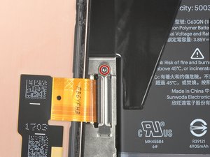

An interesting (albeit frustrating) issue recently manifested with my Pixel 7 Pro, and I can't seem to find any other reports quite like it via Google. I'm hoping someone on this forum is familiar enough with the hardware under the hood to give me an idea of what might be happening and what, if anything, I can do to mitigate this.
The issue occurs after any minor drop, and it has occurred multiple times now in the same way. After a minor drop (~2 feet w/ case), the screen at first becomes completely non-responsive -- just black. After about a minute, the power button will cause the screen to turn on, but the touchscreen will not work at all. I can force restart the phone at this point using the power + volume up button procedure, and the screen comes back on, but the touchscreen still doesn't work at all. Eventually, after multiple restarts and several minutes to half an hour of waiting, touchscreen functionality will come back, seemingly at random. At first it's hit-or-miss, failing intermittently only to come back just as suddenly. Eventually it goes back to normal -- but another minor impact will start this process over.

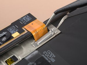

There's really only one thing to check, and if it's not that then all that's left would be to replace the screen. On the 7 Pro, unlike my 6 Pro and earlier models, the retainer for the display connector is held in by spring tension, rather than being secured by a screw. Here's a picture of your retainer.
And mine.
Of course, the only way to check it is to remove the screen. That single connector carries the signals for the fingerprint reader, the digitizer and the OLED display, so if that's the problem then it's still almost completely connected, just not quite.
You'll want to follow the screen replacement guide to open up the screen. Obviously the first thing to check is the retainer; although it seems unlikely, it's theoretically possible for the clip to come loose from a sharp impact such as a drop. If that happens, the force required to jar the retainer loose would probably also be enough to pop the connector out of its socket. So if it's just sitting in the socket without being clicked in completely, that could explain your issues.

I'd say open it up and verify whether the bracket is in place or not. If not, that would reinforce the theory that it's just a loose connector. Either way you'll want to go ahead and unplug the connector. Get out your magnifying glass and a nice bright light and check the pins on the motherboard and the connector, looking for anything bent, missing or broken. Bent pins can sometimes be straightened with some fine tip tweezers, but obviously missing or broken pins are a more serious issue.
Assuming it all looks good, clean both sides with some 90% or higher concentration isopropyl (rubbing) alcohol, give it a moment to dry then plug it back in, fix the bracket in place and test.
