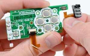

No charging light on DSi.
I have tested 2 different DSi Chargers and can't get a charging light. What should I try next?
Hi @friarbrot
Use a DMM (digitally multimeter) and check if the F1 fuse on the power board is OK. (see image below)
Here's the ifixit Nintendo DSi Power Board Replacement guide that may help.
(click on image)
Where is the F1 fuse?
@friarbrot
I highlighted it with a green box in the image in my answer
