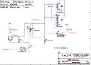

There is a fuse (F13 - model # 2A32V-9-GP) that is in the power supply to the fan. Perhaps it blew somehow after the power was reconnected, (accidentally knocked off board during repair?).
I don't know where it is located on the motherboard as I can't zoom in far enough on any images of the motherboard I have found online. Hopefully it is designated on the board.
Below is an image taken from p.66 of the schematics for the motherboard showing the fan control circuit that may help.
If the fuse is blown, unplug the fan from the motherboard and use a DMM (digital multimeter) to check if the replacement fan is OK i.e. correct resistance value between the fan's red and black wires (fan motor). Also that the red wire is not short circuit to earth (fan frame, or to other fan wires) as well

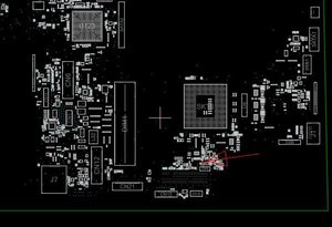

Hi I think I may have similar problem fan stopped working after i did thermal paste swop on my w520, it went crazy fast for few hours after but eventualy died now it doesnt spin at all, I have no idea where the fuse is pls help Thanks
Hi @peterpann94936
Did you ensure that there wasn't excessive thermal paste that may have flowed down over the CPU and onto the board etc causing the fan to go to high speed initially?
Here's an image showing the location of the F13 fuse on the motherboard.
