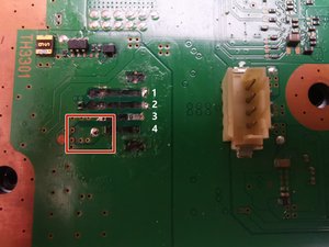

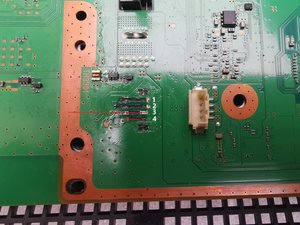

On the PlayStation 3 FAT (CECHL04) game console the power supply connector was broken off from the motherboard (4 pin). The soldering point cannot be soldered, it is very damaged. The machine was working before the plug broken off. Could someone use a multimeter to measure where the 4 pin can be connected on the motherboard?
I would need someone who has such a device and the 4 pin is on it to measure with a multimeter (the value is zero or close to 0) what other points the connection on the motherboard (1-2-3-4) are directly connected to, whether SMD resistor capacitor, etc.
I would only need the 4 connection points on the side of the broken off connector or on the other side of the motherboard.
Thanks in advance for your help! 🙂
[image|3519100]
If you have a look at the board here, you can see where that trace goes, off to the left.
You can either scrape away the solder mask (the green bits) to expose the copper underneath, that you can solder to. Or you can probably solder straight to the test point that's in the middle of that trace.
Yes, I think so too, thank you. I can solder to the test point. I need to the other 3 soldering points. The 3rd soldering point might be the one I marked in the picture, but I'm not sure.
