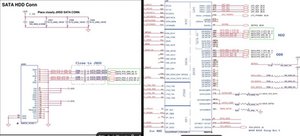

For what it's worth, here's a composite image from the motherboard schematic showing the sata HDD connections to the chipset and the power supplies.
Hopefully it may be of some help.
(click on image)
Thanks very much' do you see the 12v pinout on this map on my pinout map those last pins are numbered 1 - 15 that was what i was going on , thanks again much appreciated

All the v12 (12v?) connections aren't connected. Seems like a standard 24 pin connector is used and wired accordingly for a 2.5" sata HDD/sata SSD.

@lesliebrow19476 there should not be a 12V rail. The 2.5" laptop HDD typically uses only 5V. Double check with another drive since this issue is either your drive, or a bad master boot sector. You are not telling us if the drive is being seen in the BIOS.
We will need to know the exact model of the motherboard. It should be printed right on it. The laptop make and model will not give us the results we need to work on a schematic.
