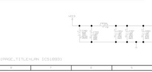

Consequences of leaving it off could vary. My inkling based on the width of that trace is that it's a major power rail and chances are it's got lots of caps, so one missing may not have huge consequences. But could mean components on that rail may wear out faster, or potentially something may not work at all depending on the purpose.

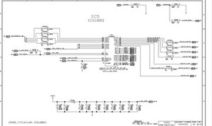

I would confirm with a multimeter in continuity mode that that side was in fact ground, by probing the little vias at the end of the little traces that pulled up and seeing if they are continuous with a known ground (areas around screw holes are usually a good bet). If ground, just make sure that leg of the capacitor gets soldered to a ground point and you'll be golden. You can repair the little traces if you want, but it may not be necessary.
Just adding that you almost definitely ripped off the negative pad, looking at this high-res image of a motherboard, you can see similar capacitors on top of that same footprint. Schematics for most revisions of the Xbox motherboard can be found online, and you could use that to confirm that this capacitor's negative pin is routed to ground. If so, then it's a pretty easy repair and you could resolder the negative end to an adjacent component electrically connected to ground.

Thanks for your answers! I made a better picture: https://ibb.co/s2HjHt4 and I found the schematics. I've attached them. It seems like the capacitor is used for the LAN port in some way. But would it be important to solder it on if I don't use that port?
Someone also sent me a picture from where to where I should solder on a jumper wire, is that correct?
