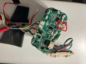

Hello, i'm trying to understand why the circuit board of EV660 is not working correctly.
Basically when i push the ON/OFF button, no power is sent to the vacuum motor, because there is no voltage on the two connectors.
  1. In picture 1 you can se the two orange pins/connectors going to the vacuum engine, to provide 22.5V DC and make it run.
  2. I've tested the on/off switch for continuity on pins and i can measure that when you press it there is continuity between lines, but when it's not pressed, red and black line are not connected. The voltage between theese two lines is 24.51V DC, delivered by the battery pack underneath the circuit. In picture 1 you can see how the battery pack is charged, through the 4 wires on the right side, connecting to the wall charger.
  3. Picture 3 is the battery pack and the missing voltage of 22.5V expected to power the vacuum engine.
What else can i check?

Hi @francescof40841
There is some sort of burn mark at the circled area. I would peel off the protective silicone and see what component is underneath it of even on the other side of the board.
I suspect that something overheated there.

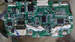

I have exactly the same problem. No obvious damage. Battery pack voltage around 25 Volts. The two fuses on the board are fine, but it seems completely dead. Did you find a solution?
Hello Klaus, no solution. Let’s keep in touch to find a solution together
Hi @klaus25214,
Looks like there's a scorch mark on the board near the the Q15? component at the top of the image under the M+ terminal.
Check if Q15 is OK as it may have gotten too hot.
If it is faulty i.e open circuit, you may be able to work out what type of component it is from any markings on the case i.e. make and model type (I couldn't when looking at it zoomed in).
If you can't it may be difficult there no schematic available online for it (I couldn't find one)
