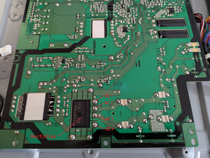

So obviously there is something else wrong with my tv. I'm still assuming it's the power board and I'm considering replacing the whole power board. I didn't notice anything visually that seemed wrong with it, like scorch marks for example, but I've added some pics of the board below if y'all notice anything that I don't.

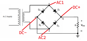

I ended up buying an entirely new power board so I'm able to compare it to my faulty power board. Here are the results from testing the rectifier on both boards. Put your multimeter in diode test mode if you've never done this, this was my first time. Also see the pic below, the rectifier and each terminal you'll be testing is labeled. I also included a circuit diagram with the same labeling since it helped me understand what was going on.
Bridge rectifier on new power board:
  • forward bias tests (online refs say it should be between 0.5-0.7 V):
    • Red probe on DC-, black probe on DC+: 0.500 V
    • Red probe on AC2, black probe on DC+: 0.466 V
    • Red probe on AC1, black probe on DC+: 0.465 V
    • Red probe on DC-, black probe on AC2: 0.464 V
    • Red probe on DC-, black probe on AC1: 0.464 V
  • reverse bias tests (online refs say it should read 0L or no reading):
    • Red probe on DC+, black probe on DC-: 0L
    • Red probe on DC+, black probe on AC2: 0L
    • Red probe on DC+, black probe on AC1: 0L
    • Red probe on AC2, black probe on DC-: 0L
    • Red probe on AC1, black probe on DC-: 0L
Bridge rectifier on faulty power board:
    • Red probe on DC-, black probe on DC+: 0.501 V
    • Red probe on AC2, black probe on DC+: 0.469 V
    • Red probe on AC1, black probe on DC+: 0.470 V
    • Red probe on DC-, black probe on AC2: 0.820 V
    • Red probe on DC-, black probe on AC1: 0.821 V
    • Red probe on DC+, black probe on DC-: 0.388 V
    • Red probe on DC+, black probe on AC2: 0.820 V
    • Red probe on DC+, black probe on AC1: 0.819 V
    • Red probe on AC2, black probe on DC-: 0.820 V
    • Red probe on AC1, black probe on DC-: 0.821 V
@ss_pp following the DC in line it goes to the bridge rectifier but I am not sure what you got going on here (red rectangle). Anything that connects in there? It does not look like the lines are closed the way the board is right now. I could be wrong, so check with your multimeter and see if you have continuity on that line the way the board is right now. If you do not have continuity, replace the fuse and plug your board in. If the fuse still fails, you know that the short is between the rectifier and the fuse. It'll be easier isolated.
@oldturkey03 Thanks for the response! I'm a little unclear on what you want me to check. Can you explain it a little more plainly? My experience is limited.
This is what I checked. The fuse is currently blown so of course no continuity across it. I did replace the fuse a 2nd time and it blew immediately, and then I checked the following. I have continuity from the fuse (the lower node in your image, opposite of where the power comes in) all they way to the rectifier node (1 above the node labeled with "+"). I looked for shorts across any components that connect the 2 traces you have highlighted with the red box, and I didn't find any. All of those components measure around 1 mega ohm.
