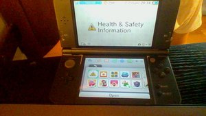

How to transfer EVERYTHING with one 3DS?

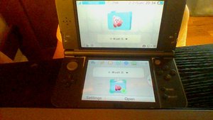

@darthmango I have FIXED IT SOMEHOW! :D So 1st of all, the movablemoveover? I was stupid, i just had to rename it movable.sed and NOT .bin lol, Then it said my old 3ds number, and it fixed my movable! and NOT ONLY THAT, I factory resetted before this, and doing research (since i didnt want to brick it if it even just said it worked.) and for some reason... i decided to go download ninfs because... on their newest update it said. FIX CORRUPT CTRTRANSFER. and after doing some research, that is the WHOLE NAND. (i think) but not the other 2 drives,) And when i did that, The ctrtransfer file came from that corrupt nand and somehow. IT GAVE ME ALL OF MY SYSTEM DATA, AND ALL OF MY APPS.
[8 YEARS OF PROGRESS RESTORED! <3]
All I did was ninfis, saw the ctrnand.img inside of the nand.bin, transfered it into my 3ds, deleted the data folder inside of CTRNAND and replaced it with the OLD, (after the transfer was done) and bam, everything worked!

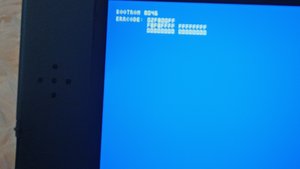

@darthmango UPDATE!! Something happened to my 3ds.. Same thing.. But one different number code. If you go back to my 1st post when. II bricked it, and looked really closely to the numbers on top, the 2nd digit changed right after I did the X+Y+SELCET+START I can't tell if its good or bad news, since if I did that and it shows a other code, it may be 100% doomed..
@darthmango.. it.. it does it without.. the r4 card.. i dont wanna get another 3ds :( i mean, ig i could ask somebody to put a new nand inside of the system and shouder the pins.. but thats really my only opinon tbh
@wyattd it's no more doomed than it was a few hours ago. In fact, it's one step closer to revival. Can you get your NAND backup from THIS console and copy it to the /gm9/out/ folder on the 3ds's SD card?

So uh.. Yea BUT EVEN WORSE, I DOINT EVEN THINK I HAVE THE NAND FOR THE NEW CONSOLE BEFORE IT WAS EVEN BRICKED.😐 so ima do some research for awhile and update you if I have it
@wyattd OK. The filename contains the console's serial number, so you can check it against that. (you probably knew that though)

Alright, final stretch! Here's what to do now:
  1. Remove the 010101 backup file from /gm9/out/ . Store it somewhere safe.
  2. Download GodMode9 from here.
  3. Copy GodMode9.firm to the root of your SD card and rename it to boot.firm
  4. Copy the /gm9/ folder to the root of your SD card. Overwrite files if it asks.
  5. Eject the SD card and reinsert it into your 3DS
  6. Insert the flashcart and boot from it (START + SELECT + X + magnet)
  7. If done correctly, you will have booted into GodMode9
  8. Press HOME, then select Scripts... > GM9Megascript > Restore Options > SysNAND Restore (full)
  9. Select your NAND backup
  10. Press A to unlock SysNAND (lvl3) writing, then input the keycombo given
  11. When the script finishes, press A to continue
  12. Press B to return to the main menu, then select Exit. Relock write permissions if it asks
  13. Hold R and press START to poweroff
  14. Insert your SD card back into your computer
  15. Download Luma3DS from here.
  16. Copy boot.firm and boot.3dsx to the root of your SD, overwriting the existing boot.firm
  17. Eject the SD card and reinsert it into your 3DS
Then just power on and hope for the best.

@darthmango and also which nand? The one that has the corrupted one or the one with came with this one I got?
@darthmango uhhhh update i did the 1st 6 steps and im not into gm9, it still says the error code but same thing, with an 2 switched instead of a 0 i did everything right??
@wyattd including the magnet?
@darthmango or maybe its the card its self for the flashcart, cuz maybe the files i did r in the wrong place like for ex the backup.bin and the enject but im sure i did it right.. ALSO BOTH CARDS WERE HEATING UP so maybe it was trying to do something idk
