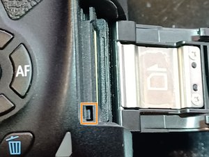

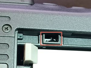

Son dropped it and its not turning on.

There is one thing you could check without needing to disassemble the camera. There two microswitches on the camera. One detects if the battery door is closed, and the other detects if the SD card door is closed. If both of these switches aren't pressed down (or if the switch is damaged), the camera will not power on. If it is one of the switches that are damaged, you'd be in luck since they'd be relatively easy and won't cost too much to replace (assuming there would be no other damage to the camera).
First check the LED indicator light on the lower-right of the backside of the camera. If the indicator light blinks when you try to power on the camera, it means the microswitches are not damaged. If the light does not blink, then you can proceed with inspecting the microswitches. The one for the battery door is the easiest one to inspect. Open the battery door and check the switch, as shown in the image below. Make sure the plastic lever on the switch is undamaged and isn't broken off.
If that switch is fine, open the SD card cover to check that switch. This switch is a bit more hidden away (see image below). Check for damage like with the other switch.
If both switches appears to be fine, than it likely is an internal component that's broken and as explained above won't be very easy to diagnose unfortunately.
