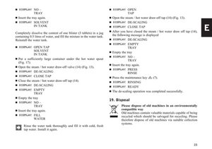

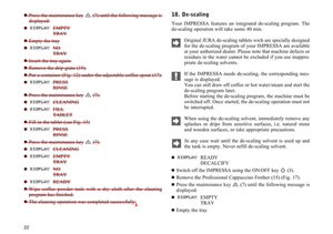

@vladyslavm48017 here are the DESCALING instructions right from the manual Chapter 18:
and in writing just in case the images are not good enough :-)
Descaling
Again, these are the DESCALING instructions, NOT the cleaning instructions

(0) Important prerequisite: machine is in stand-by, filter status off.
(1) Press the rinse button for four seconds
(2) Now empty the drip tray as requested, it must be outside for at least 5 seconds.
(3) Dissolve the descaling agent (Ammonium sulfatic acid is best) and pour it into the tank. Place a larger container under the steam outlet.
(4) Turn on the steam tap

No, this is for descaling. Perhaps I should write "maintanance button", nor "rinse button". Anyway, this is the button with six drops on it.
