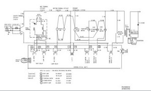

Why does my over the range microwave keep shorting out the monitor switches and blow the breaker. I can replace the monitor switch and it will work for a day or two then short out again. I work at an apartment complex and this happens on a lot of them

Is the microwave being stopped during its cooking operation by opening the door instead of stopping or pausing the oven by using the control panel options?
If so this is a good way for the monitor switch contacts to fuse together. Arcing across the contacts.
Also check the operating sequence of the door interlocks because you don't want the monitor switch to close (when the door is opened) before the primary interlock has opened as then there is a direct short across the input supply. Only for a very brief moment but long enough to blow a breaker perhaps

Here's a poor image of the wiring diagram that may also help.
As can be seen, if when opening the door with the oven operating, the monitor switch closes before the primary interlock (top door switch) opens, then there's a direct short across the input supply.

I have tried replacing the monitor switches in several units but it just doesn’t last. I have tested the door switches and they test fine when checking for continuity during open and close. I’m sure it has something to do with residents pulling the door open during operation and not pushing the stop button. I just wish I knew how to correct these as again they have just been replacing them and I bet they have replaced more than 30 of these due to this.

All you can do is when replacing a switch, is to use an Ohmmeter (power disconnected from oven) and check, when opening the door very, very slowly, is if the monitor switch is electrically closed, before the primary interlock has electrically opened, then it may be an adjustment or replacement (worn?) of the switch actuating lever assembly i.e. door latch or the position of the switch itself in relation to its actuating lever.
By using the control panel option to stop the cooking process, the R2 relay on the control board is released, which opens the power path to the HV circuit, stopping it from functioning, preventing arcing across the monitor switch, so even if the latch/switches were out of adjustment the problem wouldn't occur.
