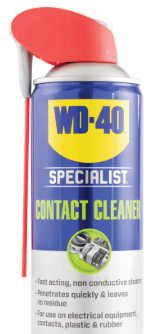

Try using some electrical contact cleaning fluid on the roller knob that control main volume.
