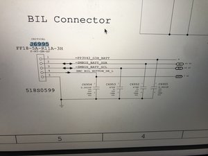

Nothing happens, i also think that the battery indicator (the 8 leds on the side of the mac) connector is broken (will it cause any problems)

@danj they are both (battery charger chip and battery indicator leds) to the same power trail.
If the battery indicator causes a short the whole 3.42 line gets 0v so the charger chip won’t work.
Did i get it right?

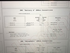

@giulioforch2043 - I’m confused! You got a fresh battery? This is showing me the batteries BMC microcontroller is bad or is unable to gain access to power to run. A fresh battery would supply the BMC its needed power at which point SMC would report values. As we can see the model info and age (which is in error) we know SMC is working! So we are still stuck with a bad battery.

@giulioforch2043 - BMC is Battery Management Controller the microcontroller within the battery. Look,at your snapshot do you see the information to the right of a callout like Mac Model that is info from SMC so clearly SMC is working. Let’s drop SMC as we are chasing out tails being over focused on it. As I have stated you need a known good charged battery to dig deeper. Otherwise it’s tracing out the power rails using schematics and board view drawings as well as a bench power supply to emulate the battery.
