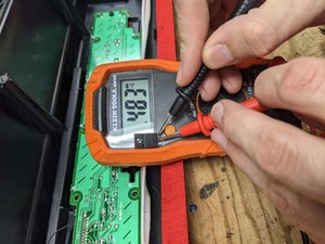

@oldturkey03 I had to take Q101 out of the board to make sure something wasn't going on with some other component in the board. Hopefully I am testing this properly like other mosfets.
I first shorted Gate to Drain for a few seconds which should open the connection from Drain to Source it until voltage is applied to the Gate. From Drain to Source I measure .485 without ever applying voltage to the Gate. D to S never opens and always stays at this value. I'll edit the original post and I think I can add the image that way.
@oldturkey03 this is what i'm measuring from D to S with nothing ever applied to the Gate
@jedwin90805 Looks like you are doing it right. what happens when you reverse your black and red probe in diode mode?
@oldturkey03 interesting, if I do that, it works as expected. If I reverse and put red on the Source and black on the Drain there is no connection. Touching the black to the Gate then makes the connection and I measure 1.9V from Drain to source which drops quickly. If I short Gate to Drain, it closes the connection as expected. I am guessing the meter just has the probes flipped in diode mode then and Q101 is actually good?
@jedwin90805 shouldn't be a meter issue. If you can get an inexpensive replacement for the FET I'd give it a try.
@oldturkey03 looking at the spec sheet, I see this is a p-channel mosfet. That would require negative voltage to turn on. The Gate threshold voltage is also listed as -10V so that would make sense that this is working properly then wouldn't it?
