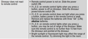

This is a screenshot from the manual- hopefully one of these will fix it.
