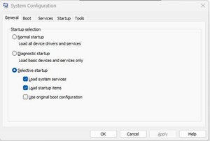

Press Windows + R key, input msconfig, and hit "Enter" to open the System Configuration utility.
Verify General and Boot tab look something like these
If they do, then there might be an HDD/SSD or CMOS issue.
