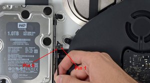

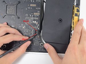

What is the internal Speakers pinout?
Hello guys can someone provide pinout for the late 2014 imac speakers. Thanks.
@mariandemirov go with the pins from the logic board
Speaker Left
Woofer
Pin 1==>AUD_SPKR_LWFR_OUT_P
Pin 2==>AUD_SPKR_LWFR_OUT_N
Tweeter
Pin 5==>AUD_SPKR_LTWT_OUT_P
Pin 6==>AUD_SPKR_LTWT_OUT_N
Speaker Right
Woofer
Pin 1==>AUD_SPKR_RWFR_OUT_P
Pin 2==>AUD_SPKR_RWFR_OUT_N
Tweeter
Pin 5==>AUD_SPKR_RTWT_OUT_P
Pin 6==>AUD_SPKR_RTWT_OUT_N
