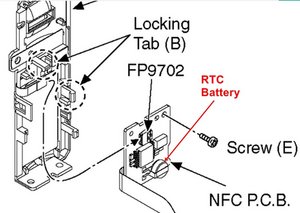

I have an old Panasonic DMC-ZS40 camera. When I change the removable main battery, the clock setting is lost and needs to be reset. I heard the internal battery might be dead. Is it possible to replace the battery? Where can it be done?
Thanks in advance for any answer.
@yj2kim The battery is on the NFC P.C.B.
Use the DMC ZS40 Disassembly right up to page 6 where it shows how to remove the NFC P.C.B. Sorry, but I have no info on what model this battery is.
