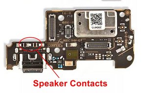

I replaced my charging port. To do so I needed to move the loudspeaker.
When I took out the loudspeaker I noticed there was no cable I had to detach to remove the loudspeaker. I'm not sure how the loudspeaker actually connects to the phone.
When I assembled the phone back I noticed the loudspeaker doesn't work. I only noticed this during a call when my speakerphone wasn't working.
I would like to know how the loudspeaker actually connects to the phone to verify my connection with the phone. If I connected it properly, or if it connects without using a cable I suppose my loudspeaker broke? Kinda odd that it broke in that fashion.

On most phones, Usually with two gold plated springs/legs that touch onto two pads on the logic board. Clean the pads with 99% Isopropyl alcohol, only if they look dark or corroded. Also clean and slightly (not a lot) pull out the springs so they stick out slightly further making better contact.
Replace the adhesive so it doesn’t move out of place. That usually fixes it. Failing that replace the speaker.
@quadmind first do a quick hardware test. On your phone go to your apps > Open Device Help > Device diagnosis > Hardware test > Speaker and see if it works (your phone actually has two)
If it does not work and since you recently worked on your charging port, I assume you are referring to the bottom speaker. BTW you did not tell us what you did to your chaging port. This will become important. The speaker is connected to the black plastic housing which functions kind of like the cone on a conventional speaker. The speaker does have two contacs on that housing.
(The speaker is actually the silver metal rectangular part). Those two contacts need to connect with the CHARGING BOARD. Here are the contacts that it has to match
The question now is what your repair entailed. If you just replaced the port via soldering, you do want to check for any solder bridges, or overheated and broken or bend contacts. If you repalced the complete charging board then check the two contacts to ensure that they are properly aligned, not bend or broke,
If in doubt, you can always post some pictures of what your speaker and charging board looks like. Maybe we can see things that may have failed. Adding images to an existing question
"the loudspeaker assembly also houses the vibration mechanics" no, it does not. The vibrator motor is acctually a separate part which is located by the reversed L cutout on the charging board (top left above the speaker contacts).
