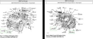

Where is the location of the oxygen sensor of Ford Escape 2003?
Hi @marpsanpedro
I think that the same 3.0L engine is used for the 2006 model as well as the 2003 model.
Here are some images showing the location of the 4 oxygen sensors that are in a 3.0L 2006 Ford Escape.
