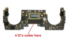

the board doesn't turn on. how can I identify the CPU/RAM/Storage from the board? are there any markings on the notebook or the body itself?

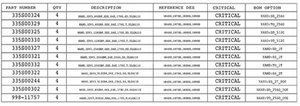

The only other way would be by looking at the memory IC's itself. Each one of the 8GB and 16GB configuration uses 3 different IC's, which leaves you with a total of 6 possibilities. Commonly used IC's are HYNIX, Micron, or Samsung. Apple, in it's habitual paranoid way, may have had those IC's marked with their own part numbers:
333S00125
333S00068
333S00166
333S00126
333S00070
333S00167
those are all LDDR3-2133 BGA178 IC's but are different and not just in capacity.

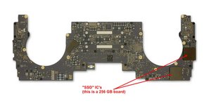

As for your "SSD" storage, again, you are dealing with NAND IC's Apple commonly uses Toshiba IC's for these (may or may not be marked in the APPLE Way :-) Here are the numbers for those
and here are the locations
The boards with a higher storage capacity do have additional solder points. I do hope that this will help you out. Of course, you could also just post a couple of good pictures of your logic board (both sides and IC covering removed) so we could help you further with this.

@garegin - The only way is to take note of the chips ID and Google it to see if you can find it. Or if you can find the systems schematics the chips ID will be listed. The RAM is within the SoC module and you could have two or four Flash chips.
