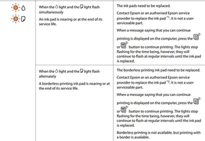

My epson l3211 printer model both red light blinking continuesly
my epson l3211 printer model both red light blinking continuesly
Hi!
According to the user manual, it's probably something to do with the ink pads in the printer:
It reads like you can press a button on the printer to continue printing anyway, but it'll keep nagging you to change the pad.
You can check the manual here https://download.epson-europe.com/pub/do...
