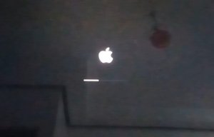

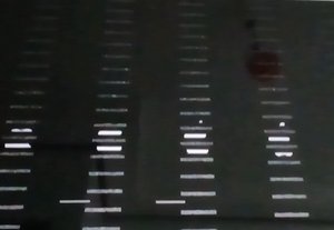

What causes these strange objects to flash up on boot screen?
I noticed this happens ONLY when I start up this MB Air A1466 13" 2014 (BigSur)
It flashes up for a split second then is gone and everything is running smoothly otherwise. It is a clean install of BigSur.
I found this video https://www.youtube.com/watch?v=QYLOhbrn... but the MB Air series has built in RAM, but it is a similar grid of squares.
Update (07/17/24)
@codywankenobi It is a fresh clean install on a MacBook Air 13" 2014 with BigSur and with all the latest software updates as that is all I have done to it, no other settings have been changed. I never noticed it before the install as it was reinstalled when it arrived here. @danj There are no SO-DIMM RAM or removable modules on MacBook airs. The. video I linked to was the nearest thing I could find to this issue and it was from a MacBook Pro 2012 I think. Is there any fix for this or should I just try another clean install? Because when it goes for sale it is not a good look....

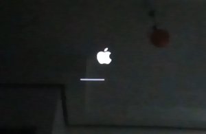

I did change the resolution to 1280x800 or something, when I reset to defaults the shapes are no longer happening at boot!
Has this only recently started to happen? This is usually from older systems or graphic drivers and happens during boot/startup due to the drivers being intialized and the screen registering/resetting itself to the correct configuration to make ensure everything is operating correctly. Make sure your drivers are also up to date as well as make sure the Graphic/Resolution settings are set correct so they dont exceed the refresh that of the gpu/or intergrated gpus specs.
@danj I have reset the display to the default setting as I did change it from the default to 1280x800 so I can read it better and now is all fine :) Odd that it does this if you change a resolution.... never seen it before.
