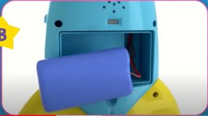

I am looking for a replacement battery pack. The “help” desk said to get one on Amazon but I can’t find any. If someone would please tell me a battery pack model number or a source for the battery it would be greatly appreciated.

We do know this much; the battery is specified as a 7.4V 1200mAh Rechargeable Lithium Battery. I grabbed a screenshot from the battery installation video here.
This gives me a fair degree of confidence the battery pack is most likely made up of two 18650 standard Li-Ion batteries. You'd be looking for a pair of batteries with individual ratings of 3.7V (7.4V / 2) and 1200mAh current output. The only way we can get any more information would be for someone to disassemble their battery pack and post the pictures so we can see what's inside. It may or may not have a circuit board called the BMS, or Battery Management System. If it does have one, then you'd want to reuse it if you cared to try replacing the battery cells.
I couldn't get a good look at the connector from the video, so I'm not sure what that takes, but that's something that should also be reusable in terms of rebuilding the battery pack. Most likely the two cells are connected with a strip of nickel metal, which is generally spot welded on.

Sorry I don't have better news for you; it's possible some of our other experienced members may know other places to look for an exact replacement. If we can get a good look at the connector and what's inside the battery pack, that would give us a better idea of what to look for.
