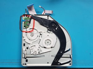

Hello so mys PS5s disc drive has been ejecting disc even if there is no disc inside and if I press the disc eject button only a single beep is heard instead of the 3 continuous beeps.alomg with this it does not even accept discs.i think the PS5 thinks that there is a disc even if there is not disc inside .I have even opened it since it's out of warranty and I found nothing wrong

It does sound like the drive it’s sensor is faulty!
The part is circled in red and so that part need to be replaced!
The problem is, that it’s very difficult to find that part and so it’s probably easier to replace the whole drive. This should fix the issue.
Guide: PlayStation 5 Optical Drive Laser Replacement (till step 33).
Good luck and let us know how it goes!
