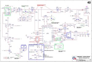

No power indication on Power Connector
Model: 17-cb1055cl
Product ID: 1X445UA#ABA
Core i7-10750H - GeForce RTX 2070 - 1080p
Not white or amber. Tried a different power supply; no joy. Opened the laptop and measured the voltage on the 20 pin connector that goes from the Power connector to the motherboard, and it measures 19.6 volts.
Removed and tested the SSD and HDD. Both work. (I backed up both while I had them out of the laptop.)

I started disassembling my HP Omen 17, and came up with the following designation from the motherboard, as you instructed:
GPC72 LA-J672P
Rev: 1.0
2020-03-26
Made In China

@georgebochar just thought of something. Where did you measure "on the 20 pin connector " this? On the board connector?
@georgebochar we need to know what motherboard your HP Omen 17 has. It will be written on the board.
This sounds like you are having issues with the power circuitry on the board. Could be as simple as a power fuse to as complicated as finding a failed MOSFET or voltage regulator. Post some really well focused and large images of your motherboard with your question so that we can try and assist you further with this. You will need a multi-meter and the right component layout file to narrow the issue down. You'll be looking at things like this
which is for a HP OMEN 17 DAG37AMB8D0 board

@georgebochar UV42 is a FET multiplexer and i don't think that is the issue. Of course, you need to test it to see if you get power to it. Here is the datasheet CU257 Multiplexer Check the VCC voltage on that. K2M40 with the SOT-25 package looks like a XC6366 and it is a DC/DC PwM controller. Check the voltage for VDD and Vout. Here is the datasheet for that XC6366 V2

@georgebochar not sure where you replied to me but I most certainly do not show any images from you anywhere, nor do i know who Miranda P is. You may need to research this. Anyhow, we still need to see what you got going on there. Post your images with your Question and you still need to identify or motherboard for us.
@georgebochar the processor is soldered, so if you replace the motherboard, the processor will be on the board.
I am so sorry but we will need some better focused images. We need to zoom in quite a bit to determine the components and pathways etc. Images need to be well focused and taken straight on. We can't see what is going on when the images are angled.
I have not yet found a schematic for your board which is a Compal LA-J672P
