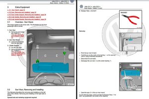

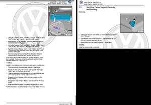

How to replace sun visor?
How to replace the sun visor on driver’s seat
Hi @jaswinders16211
Here are some images from the 2018-2022 VW Jetta repair manual that show what to do.
(click on images)
