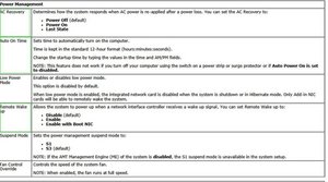

Mine starts itself during the night and is ON when I come into my office each day. It must be some command in the Registry.
Hi @johnwarner15792
There are 3 settings in BIOS that can turn the PC on automatically.
Here's an image from the Optiplex 780 service manual showing what they are. See the 3 highlighted in green
The 3rd option Remote Wake Up is only if the PC is connected to a server so that it can boot up i.e. it doesn't have an operating system installed in the PC itself.
(click on image)
