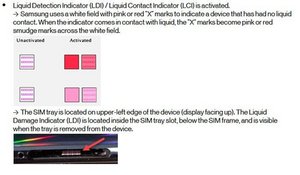

Here's an image that shows where to check if water has entered the phone if you ever wish to verify that this has happens.
(click on image)
