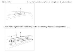

How to replace top brake light
https://www.youtube.com/watch?v=lSw66Ppy... This is the best I've been able to find so far.
@walterhitchcock and if the video is not enough :-) here are the instructions
