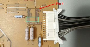

@volvo142rally 4 blink code is an LED driver failure/LED voltage protection. This happens if your backlight strips have failed. It also happens when there is a panel error and it does not communicate with the rest of the TV, which is possibly a bad main board. Since your TV is a Sony and they have had issues with the backlights, that would be my first step.
There is a way of bypassing the 4 blink error but it is a bit different from main board to main board. We really would need to see your boards to possibly help you with a temporary bypass so you could at least check your back lights etc.

@volvo142rally try to bypass teh BL ERR circuit. Disconnect the wire (Pin 1 on your connector is teh one that corresponds to BL_ERR) from teh connector. Usually those are held in place by little plastic tabs. A small needle and lifting the tab usually frees teh wire. Then you connect that to either ground on you connector (if you have a free opening or you can connect it to ground by connecting it to the metal cover of the display panel). That will bypass the signal for the BL_ERR and should allow you to turn your TV on. If it does, you may notice dark spots on your screen etc. which will be coming from the failed LED's that are responsible for this error to begin with.
Let us know if this works out for you. Most Sony's are good with the ground connection but on some models this may not work.

@volvo142rally sorry to ask. Can you take some close-ups of the two connectors for the motherboard etc, including the legend (first image, top right connectors)? That way we can figure out how to attempt to block the error reporting.
@oldturkey03 Close-up uploaded, is that the only board you need a close-up of?
I checked all the voltages in that legend, they all seem good while it's booting up.
The bypass did not work for me, it still goes to the 4 red code.
Weirdly one of the many times I tried grounding the BL ERR all the back lights came on for a short time, but I could never repeat those results.
I don't know where to go from here.

I had to have all the backlights replaced
@volvo142rally replacing the backlights fixed this?
Yes, I took it to a shop and they replaced all of the LED strips and it has been fine ever since.
