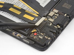

I have a Oneplus model 3 with a few issues, one of which being that it won't charge, if it helps the screen is slightly disconnected, but I believe the issue was before the screen separation, what parts would it be best for me to check and how would I get to and replace those parts? Thanks

Once you've gotten those eliminated as the. source of the problem, we have to conclude the issue is inside the phone. In there, we've got like four components to consider; the charging port itself, the cables connecting the charging port to the motherboard, the motherboard itself, and finally the battery.
Given the design of the phone it does appear there's one connector that could conceivably come loose; that's the lower plug on the interconnect cable between the daughter card and the motherboard, so you could open up the phone and check that as a first step.
With an intermittent issue like yours, the most likely place to start for me would be the charging port. That's the part exposed to the outside world, and is subject to wear or damage from being plugged and unplugged, especially from stress when a cord is plugged in. iFixit only has a guide for replacing the entire charging port, but apparently it's not too difficult to remove the USB-C port from the daughter card once it's out. Here's the iFixit guide.

That's where I'd start; replace the port then reevaluate. If for some reason that doesn't do the job, the next step would be the interconnect cable right next to the charging port cable would be worth a try.
OnePlus 3 charging connector cable repair - Free guide - SOSav.fr
From there, about the only thing left would be the battery itself; it doesn't really sound like the issue with your phone, but if you've replaced the two previous parts then other than the daughter card itself, that's all that's left that you could fix yourself. The motherboard should be saved for last, since board level repairs on phones requires equipment and expertise generally pretty far beyond us home DIY-ers.
To sum up, I'd check the connectors first, then replace the charging port and see where you are. Try that then come on back and let us know what you've found and if that fixed it or not.
