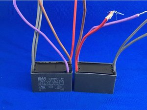

Also for the 1.5µF + 1.2µF + 3µF capacitor example linked above, if you do decide to use it, be sure to insulate the wire connected to the 3µF capacitor input side i.e. not the common output side, so that it won't cause any problems. Either that or cut it off.
If I used the "1.5µF + 1.2µF + 3µF" as well as the 1uF you suggested how would I wire it up ? If you can see in my 2nd photo my current capacitor has a Brown, purple & red wire as well as 2 gray wires !
@sdavis96819
Withe the 1.5µF + 1.2µF + 3µF capacitor the 2 greys are the common output so wire them to where the existing grey wires went.
Then wire in the the 1.5µF brown wire to where the existing brown wire went,
The 1.2µF red wire to where the existing red wire went.
Then insulate the purple 3µF wire so that it doesn't touch anything electrically. Don't cut it yet in case for some reason the wire colours don't match the usual way that they're connected inside the capacitor.
With the other 1µF capacitor you would wire 1 black wire to where the existing purple wire went and the other black wire where the grey wires are connected.

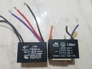

I found a Reddit thread talking about how to wire these up, and it included this picture.
If yours follows the same layout, then it would correspond to the following connections.
1.25uF Red
1uF Purple
1.5uF Brown
Ground Grey / Grey
So the two grey wires are both grounds, and you can use one or both of them. Each of the three capacitors should be wired between the given colored wire and a ground. So if you buy three separate capacitors, you'd wire them to wherever the existing wires go as follows.
1.25uF Red to Grey
1uF Purple to Grey
1.5uF Brown to Grey

This one is really scrambled according to the colors. Here's how you'd wire it
1.5uF Red to existing Brown
1uF Brown to existing Purple
Gray to Gray / Gray to Gray
Then you'd still need a separate 1.25 to go to the existing Red / Grey connections.
