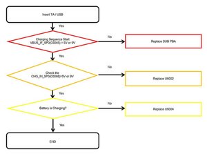

@bellaonez first follow the steps outlined by @stuig Quite right about the flex cable from the Sub board (charging board) to the Main board. Those do come off quite often.
Now, if that should not resolve anything, you will have to disassemble your phone. Use these guides Samsung Galaxy A70 as well as videos like this. Next follow the flowchart for the no charging issue
and here are the components to test
Bottom line: flex cable, battery, Sub_PBA (charging board), Charging IC. The charging IC will always be last. You do have to check it according to the values listed in the flowchart.

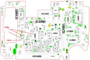

I have this particular problem too, and cannot seem to figure out what the problem is. I have already opened up the phone, I have taken off the flex cable, and I want to know, how do I check if my VBUS-IF-SP0 connector is okay with a voltmeter. I Have tried a hard reset, it did not work.
@elijusskersys you check the voltage on C6045 and see if you get the 5V or 9V
@oldturkey03 How should I take off the protecting metal?
I have a question, what is the SUB PBA?
@elijusskersys that is your Sub board or the daughter board (charging board) By protecting metal I assume you are referring to the EMI shield. Some are soldered on and some are just clipped in. If it is soldered you can desolder it or you can use some small shears to cut those (careful so you do not ruin any component)
