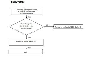

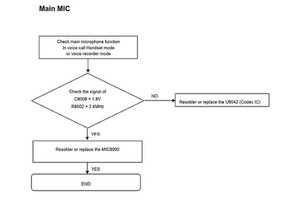

If none of the software updates and reinstall does not resolve this, consider this a hardware issue. I'd start by following the flowcharts for your phone
and to find the components to test, use this Component Layout and use the search function on your PDF reader to locate them on the board.

@calamari8860 since you do not want to open it, check the mic's first. Try to get into the Audio Loopback Control by dialing *#0283# and see if the mic's pass the test. If they don't you know that you will need to replace whichever mic has failed.
Both of them work in that test. However the RCV_DualMic sounds much less louder than the SPK_2ndMic (when holding the phone next to the ear like in a call).

@calamari8860 sounds like a hardware issue. Now you would have to follow the troubleshooting flowcharts to work on the components.
